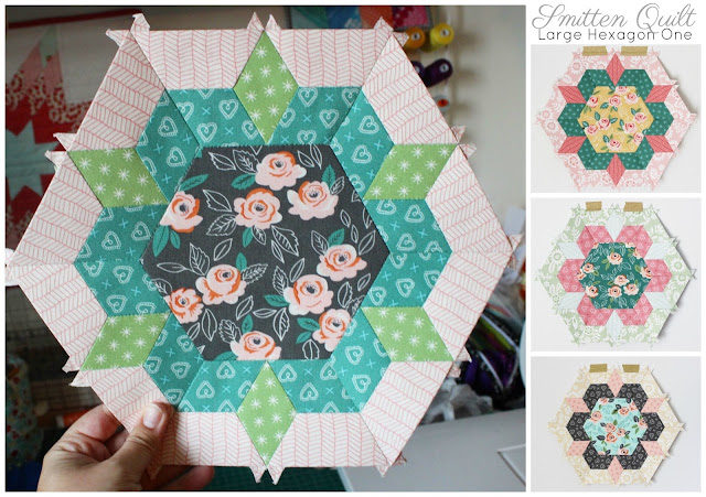

Now that I've completed all of the Large Hexagon One blocks for my Smitten EPP quilt, I thought I'd share a few tips with you that I learned along the way as well as the notions I used to complete these blocks.

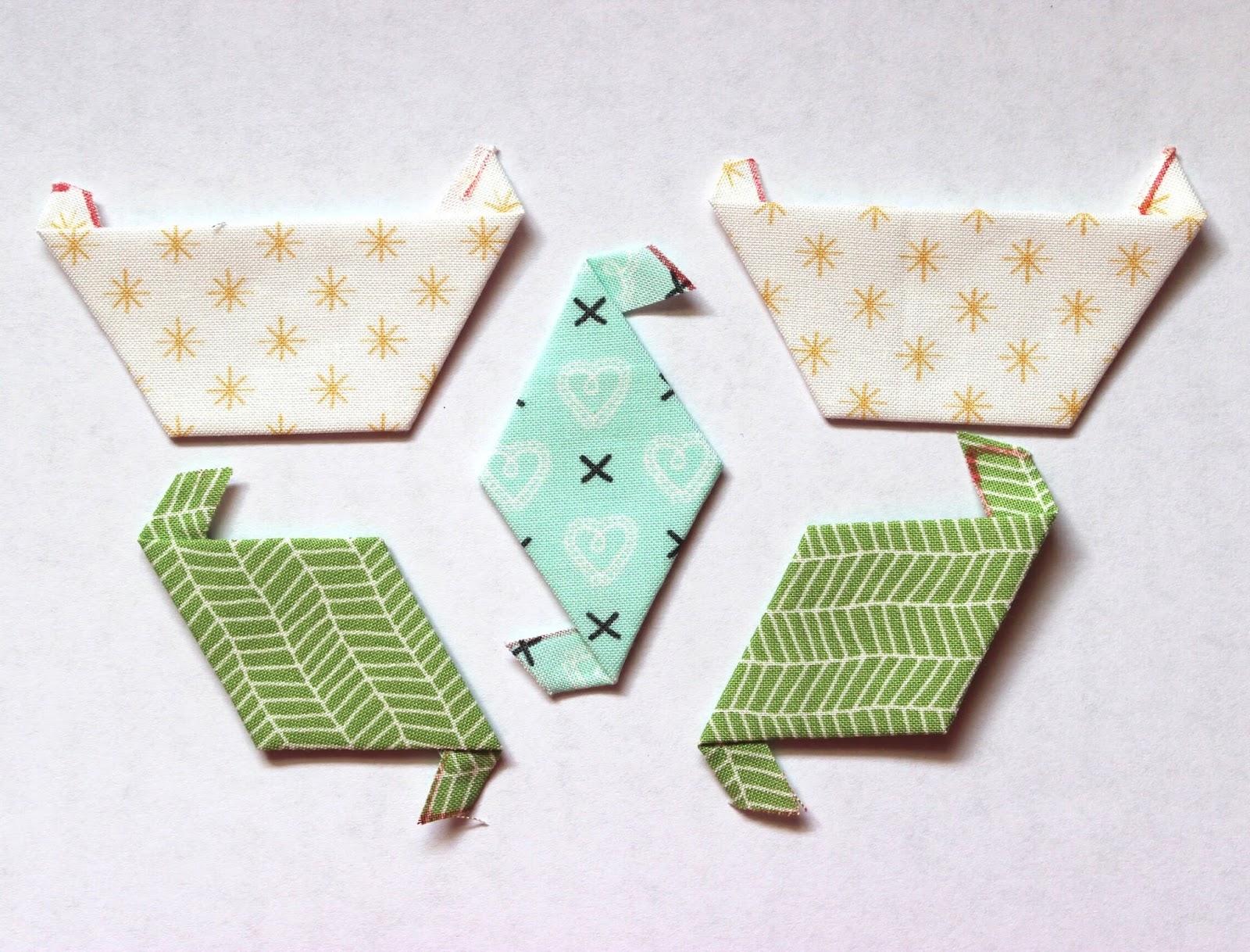

Basting EPP pieces:

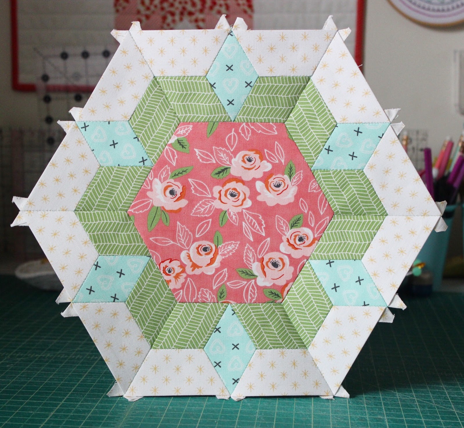

As I've posted my blocks in the Jen Kingwell Designs Group on Facebook, I've had a few questions about what the backs of my blocks look like and how I baste the smaller pieces.
The main thing to remember is to make the "points" of your folded fabric on the paper pieces to all go in opposing directions if possible (see below). This ensures there will be less bulk on the backs of your blocks. As you can see here, none of my points are facing one another and this is key in making a nice flat block, you don't want any points overlapping if you can avoid it.
